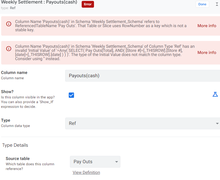

Hey There,
I would like to pull data from payout table to weekly settlement table ( pay out record)  as initial value, what I did is, I made the pay out record in weekly settlement table reference to payout table to that specific record.
when I put this formula to pull the data:
Any(
SELECT(
Pay Outs[Total],
AND(
[Store #]=[_THISROW].[Store #],
[date]=[_THISROW].[date]
I got this error "The expression is valid but its result type 'Price' is not one of the expected types: Ref"!!
I would be appreciate if you help me to do that.
Thank you
Dafer
scrnli_2_23_2022_12-01-57 PM.pngscrnli_2_23_2022_12-00-12 PM.pngscrnli_2_23_2022_11-59-22 AM.png
Good to hear from you again. Looking at your issue I am not sure I fully understand so I will have multiple suggestions.
  1. AppSheet is correct, row number is not a good primary key, normally I set as the first column in any table as the ID and set that as the primary key. (You may need to regenerate structure for it to appear.)
  2. So when there is a problem with the column types the easiest thing to do is to change the column type to what it says you need. Looking at your formula It appears to me as though you want to get an output of the total column in the Pay Outs Table. That desire is of type price not ref. Here is a potential explanation: Just because you use information and values from another table does not mean that you are of type reference. In fact, you can reference to another table and still have any column type be used. When a column is of type ref then it is looking for a primary key from some other table to be present.
  3. If you want to provide a reference not prices you can change "Total" to whatever the primary key of the pay outs table is and that will create a reference.
  4. If these are not your solutions then I would like to request images of the columns and tables they live in that are being used. (store #, date, total) As well as where the column you are trying to create exists. Additionally I would request to see the image of your data relationship in the info side menu and the Spec tab.
Personally I think solution 2 is your answer and explanation, change the column type to a price because ref is only needed when you are wanting IDs from another table.
I hope this helps, please let me know if not and I would be happy to look into this more for you. Also feel free to blur any part of pictures you may need to. I know that is often something that stops people from including images and I understand and am able to work around that.
Craig
QREW Technologies
Thank you so much, yea I got it and now it's working properly
