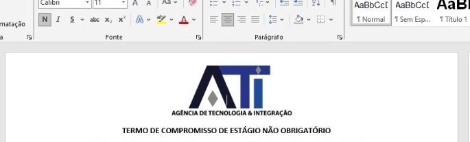

Follows images about the attempt, the margin and position of the image in the first, and the result in the second
WhatsApp Image 2024-02-05 at 22.27.10.jpegOpera Instantรขneo_2024-02-05_194604_drive.google.com.png

Thank you AleksiAlkio, it worked when I reset the margins in the .docx document, but it didn't work when I reset the margins in Google Doc, so I changed all the templates to Microsoft Word documents
It works with the gDoc as well. If it doesn't, there has to be something wrong with your setup.
