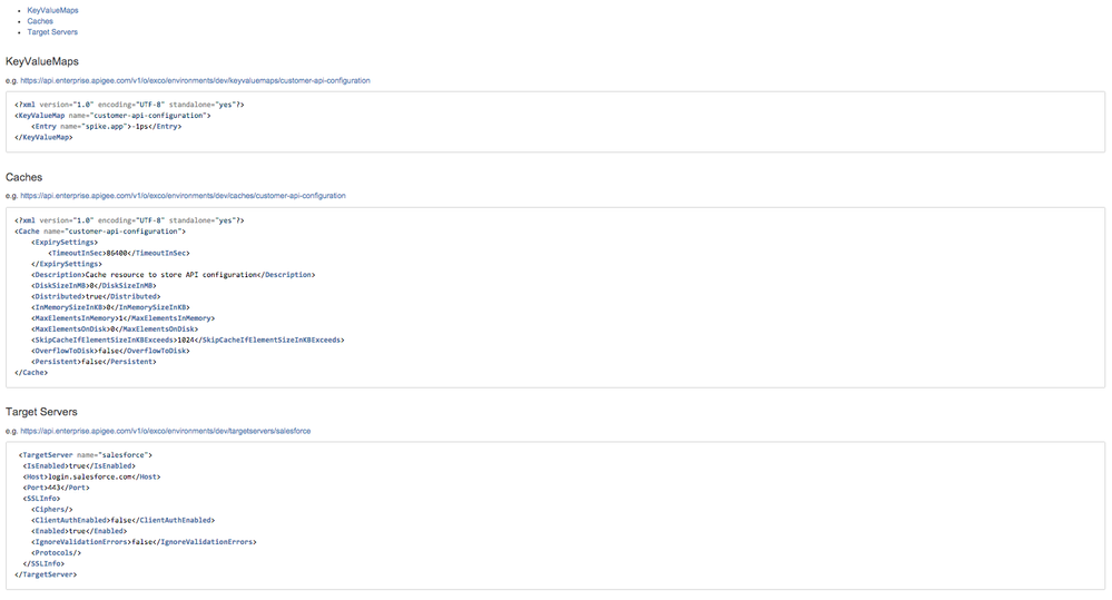

Configuration and Maintenance Manual
Configuration and Maintenance information that API Developers and API Maintainers will need to understand
Typically this will cover the following items that are specific to this API such as
  • Key-Value Maps
  • Caches
  • Target Servers
This provides a single place where Proxy Maintainers can look at the configuration options for this API that do not require proxy redeployment.
That's not to say these changes would be uncontrolled, changes to the above items could still be controlled through Management API calls triggered through a CI tool based on changes in Source or Configuration Control.

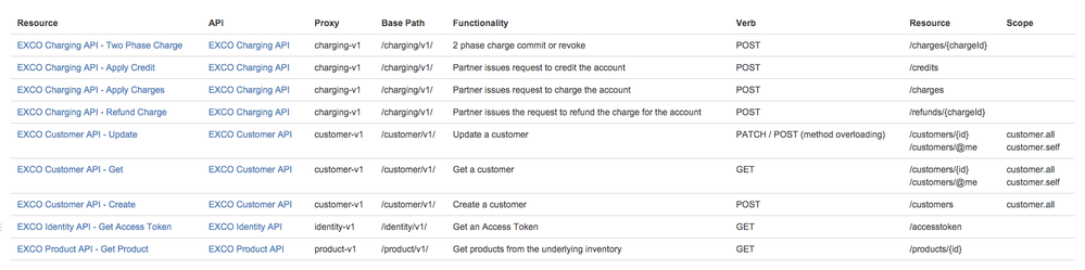

API Catalogue
Documenting the API in a Wiki based tool allows for the aggregation of resources and errors in one consolidated list which is useful for Product Owners, API Developer and API Maintainers.
e.g. Here's an example of a Wiki based report you can put together to view all the resources across all your APIs.
