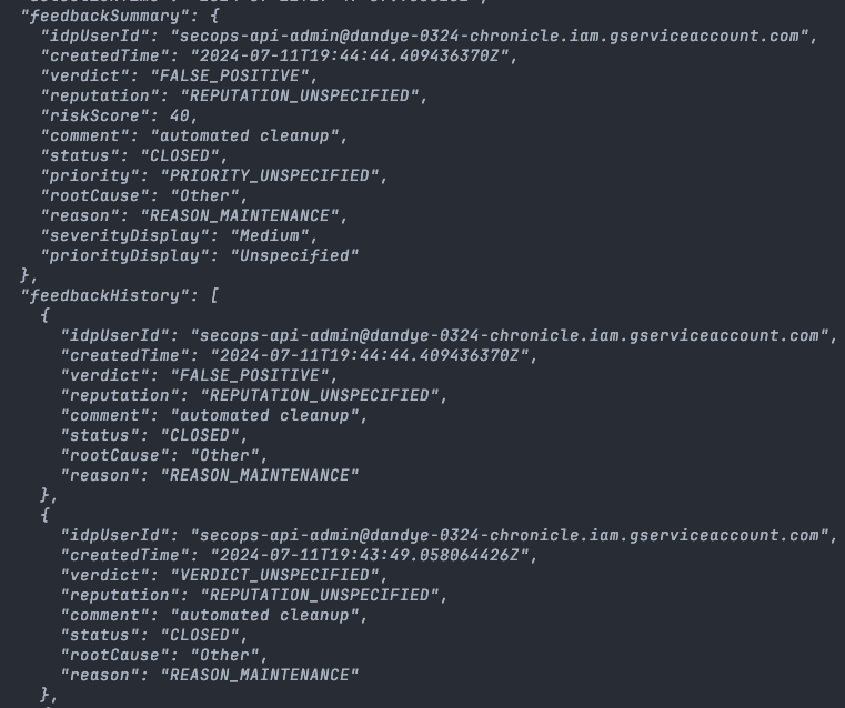

When alerts are closed, feedBackSummary and feedbackHistory objects (collectively, “feedback”) are added to the alerting detection’s JSON representation. As shown in the screenshot below, there is only one feedbackSummary (the latest) but feedbackHistory is a JSON Array with the first item being the most recent. To close the alert, we set the feedback status to “CLOSED”.
feedbackSummary and feedbackHistory Objects in the JSON representation of a Detection/Alert.

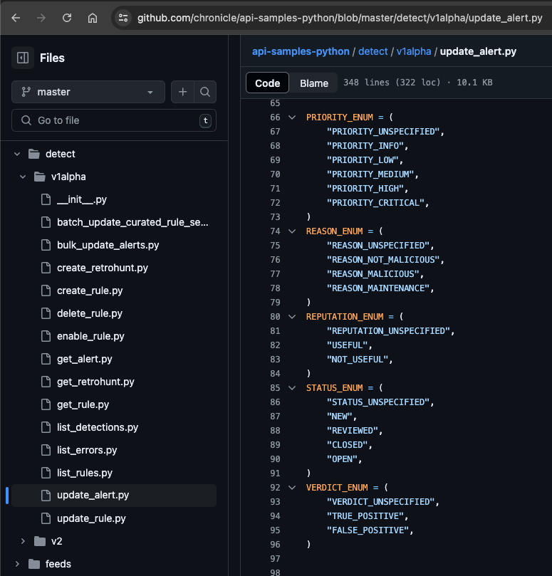

Note that the values in DEFAULT_FEEDBACK that are in ALL CAPS are enumerated vocabularies (“enum”). In the Reference for JSON representation of FeedBack shown in the image below, the vocabularies’ allowed values are linked on the enum noun (Verdict, Reputation, etc.).
Reference documentation for JSON representation of FeedBack
Those enum values are also specified and enforced in the update_alert.py Python file (see image below) and imported and used in bulk_update_alerts.py as well.
GitHub view of update_alert.py file’s enumerated vocabulary values.

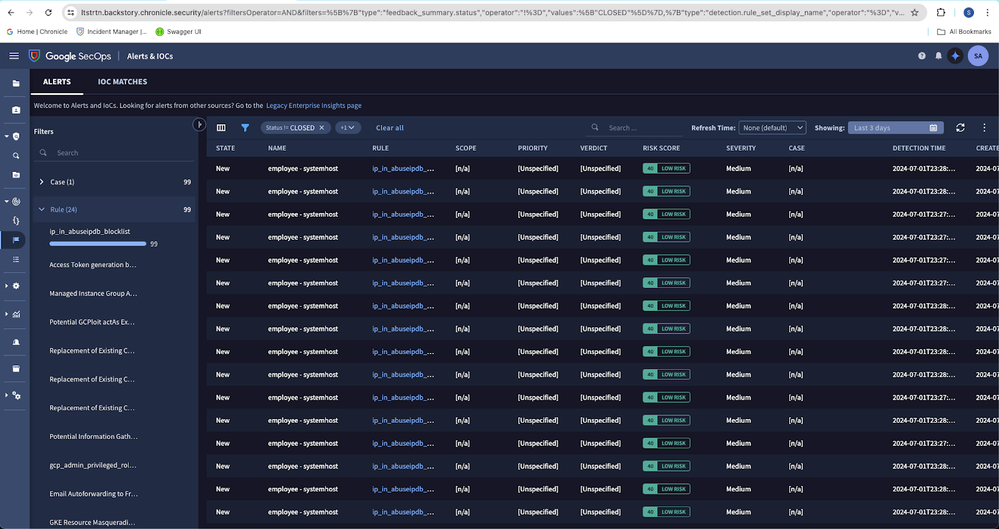

In the screenshot below, you can see that I’ve now got 112 Closed alerts for that rule. Where did the extra 13 alerts come from? That Abuse IPDB rule is so general that while I was writing this, it generated real (script-kiddie scanner) alerts in addition to my synthetic USER_LOGIN events.

    "feedbackSummary": {
      "idpUserId": "secops-api-admin@dandye-0324-chronicle.iam.gserviceaccount.com",
      "createdTime": "2024-07-01T22:41:42.747024063Z",
      "verdict": "VERDICT_UNSPECIFIED",
      "reputation": "REPUTATION_UNSPECIFIED",
      "riskScore": 40,
      "comment": "automated cleanup",
      "status": "CLOSED",
      "priority": "PRIORITY_UNSPECIFIED",
      "rootCause": "Other",
      "reason": "REASON_MAINTENANCE",
      "severityDisplay": "Medium",
      "priorityDisplay": "Unspecified"
    "feedbackHistory": [
        "status": "CLOSED",
