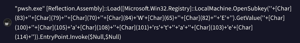

  • String concatenation, constructing commands by adding smaller parts together: "Hello"+" "+"World",
  • Representing characters in different ways, like escaped hex characters (\x42) and [char](123) syntax in PowerShell, and
  • Inserting caret (^) characters inserted where they are ignored by Windows: "C:\Windows\system32\cmd.exe" /c "stArt /MIN "" P^oWErs^h^E^L^L.E^X^E -eNC.

How can we detect this kind of obfuscation? It's clear to a human that these commands look very different from normal commands. Can we count some of the unusual substrings we see in these examples, and alert when the sum exceeds some threshold?
Feature Selection
We could go deep into data analysis to find the most distinctive features, but that's a post for another day! Let's test our hypothesis with just a few substrings that jump out to me:
  • [char]
  • \x
