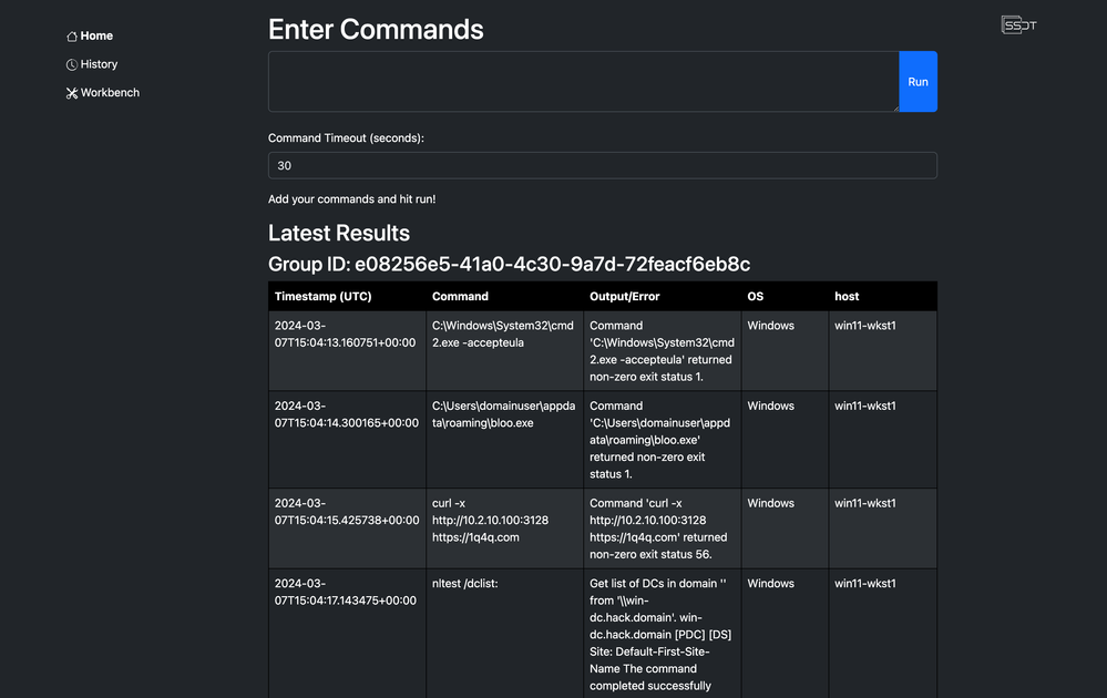

Next, I’ve configured a tool that I created recently, SSDT which is a Python Flask application that gets deployed to a Windows endpoint and enables the execution of commands for testing purposes. Results and common run commands are stored in a database.
Viewing SSDT’s homepage that shows results from recently executed commandsViewing SSDT’s homepage that shows results from recently executed commands

After copying the command from the workbench, I head back over to the home page and execute it via the Run command box. The results shown in the screenshot below are returned almost immediately.
We can see below a few columns as well as a dedicated unique group identifier associated with this run. This helps you go back to reference it later and also add it to your detection idea in the next steps for later reference.
Reviewing the output from a command executed via SSDTReviewing the output from a command executed via SSDT
