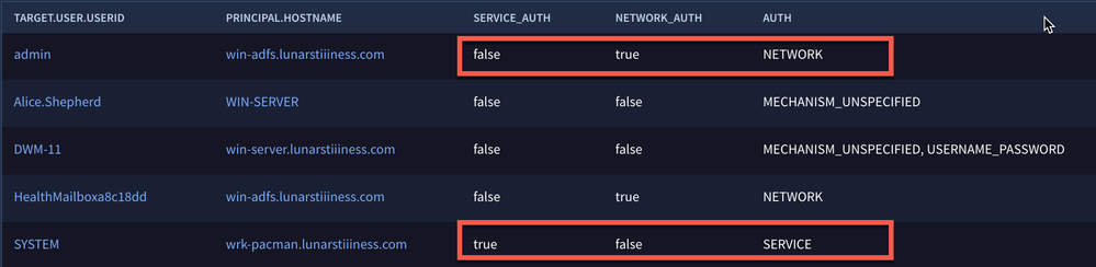

Notice in our results that we are returning true and false for both the $service_auth and $network_auth values. cast.as_bool translated the 1 and 0 values to true and false, respectively.
