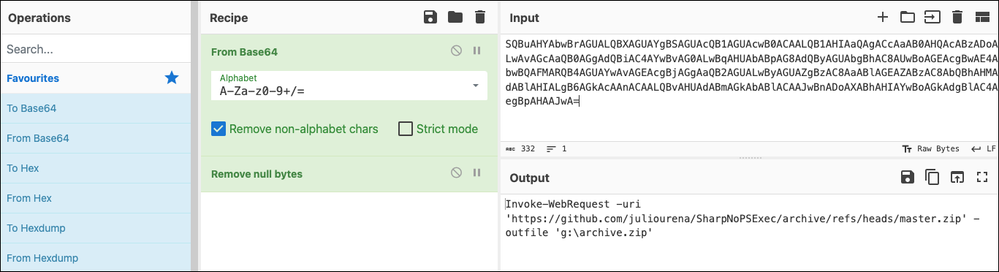

The problem that you can often run into when decoding PowerShell is that it will output in UTF-16, which has two bytes per character and the second byte becomes a null byte. To illustrate, we have the encoded PowerShell loaded into CyberChef and converted to base64 in our first example below.
Because the output doesn’t have anything to describe the second byte, we see a period to denote that extra byte.
And in this example, we have added to our recipe the removal of null bytes.
Notice how those nulls fall away and we are left with something a bit more legible? In our rule, we are trying to perform a regular expression match against something that looks like the first example and the regular expression can’t find a match. So, we are left with a few options.
