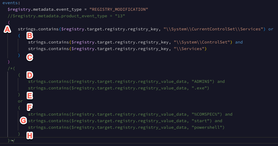

#7 - Grouping logic with parentheses
Parentheses are great for handling a mix of logic in a single rule. However, placement of the parentheses can shift that logic and cause rules not to trigger. The example event section here is based on an example from the Sigma rule set. Without dissecting the Sigma rule, at a high level we are expecting ((A or (B and C)) and ((D and E) or (F and G and H))) for the rule to trigger.
Here is a breakout of the parentheses and grouping in YARA-L with this complex logical expression. As you build out rules with logic that mixes AND/OR/NOT, laying out the logical expression ahead of time can make it easier to visualize the rule you are attempting to build. Just remember that within a parenthesis AND is not assumed so AND and OR must be used to separate portions of the larger expression.
events:
   $registry.metadata.event_type = "REGISTRY_MODIFICATION"
       strings.contains($registry.target.registry.registry_key, "\\System\\CurrentControlSet\\Services") or
           strings.contains($registry.target.registry.registry_key, "\\System\\ControlSet") and
           strings.contains($registry.target.registry.registry_key, "\\Services")
           strings.contains($registry.target.registry.registry_value_data, "ADMIN$") and
           strings.contains($registry.target.registry.registry_value_data, ".exe")
       or
           strings.contains($registry.target.registry.registry_value_data, "%COMSPEC%") and
           strings.contains($registry.target.registry.registry_value_data, "start") and
           strings.contains($registry.target.registry.registry_value_data, "powershell")
#8 - Commenting out lines
When building logic like we just discussed, a good technique to troubleshoot portions of a logical expression is to use the double forward slash // to comment out a line. Alternatively, the /* and */ will comment a multiline portion of the rule. Using the above example, ((A or (B and C)) and ((D and E) or (F and G and H))), perhaps we want to just make sure detections are firing using the rule test with a less complex expression first, like (A or (B and C)). We could comment out the second half of our expressions using /* and */ until we are satisfied with the results from the first part of our rule and then incrementally add additional logic to our rule. This commenting can be incredibly useful when trying to isolate a specific problematic line of criteria and can be used not just in the events section, but anywhere in the rule.

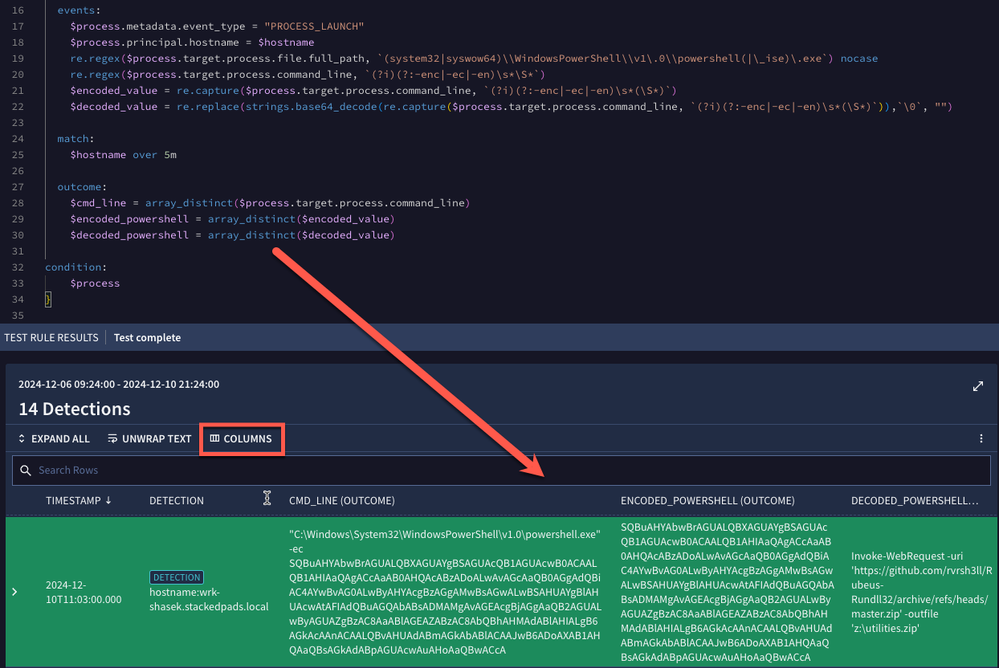

#9 - Outcomes to view values
The outcome section is a great place to perform troubleshooting because it is responsible for outputting values that can be used in other platforms when a rule triggers. These outcome variables are available for viewing in the test rule results by clicking the columns button and adding them to the view. In the example below, we want to manipulate the field that contains the command line and perform a regular expression capture and base64 decode. If we leave those expressions in the events section only, we won’t be able to view the transformed values. Adding outcome variables provides a method to view the values being manipulated in the rule and makes it easy to tune the expressions in the events section and re-test. Once we are happy with the results, we can remove these variables from the outcome section if we no longer need them.
