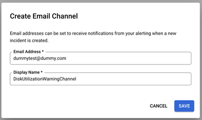

Step 3: Configure notification channels
To configure notification channels for your alerts, in the Google Cloud Console, navigate to Cloud Monitoring → Notification channels. You can choose from available notifications or create a new channel.
Configure notification channels in Google CloudConfigure notification channels in Google Cloud

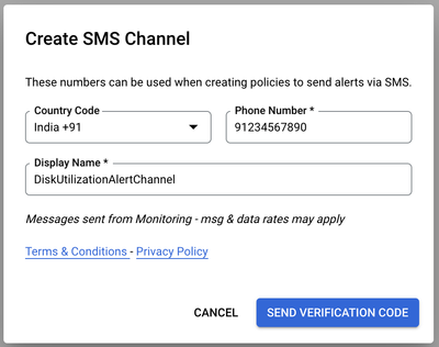

For our use case, we'll create two new notification channels - "Email" and "SMS," for warning and error limit notifications.
  1. To create an Email notification channel, click on "ADD NEW" and proceed with the required values.
  2. To create an SMS notification channel, click on "ADD NEW" and proceed with the required values.

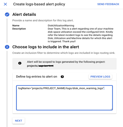

Step 4: Configure the log-based alerting policy
Navigate to the Google Cloud Console → Cloud Logging. Follow the below steps to configure the new log-based alerting policies.
  1. Click on "Stream logs"
  2. Click "Log name" and choose the log name, disk_mon_warning_logs and click "Apply"
  3. Click "Create alert."

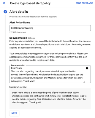

  4. Fill in the required information and click "Save" to continue.
    Provide the alert policy name and email content.
    Select the log file name for the alert.

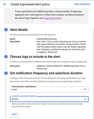

    Select the notification frequency and incident closure duration.
    Select the notification channel for alerting.
