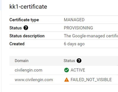

Hi, i am new in GCP, with not much knowledge.
I have my domain www.civilengin.com under Google Cloud Console, created with Google Web Designer.
When somebody opens my website, a message "Not secure" site appears.
I followed all GCC directions, Load balancing and DNS IPs are matching, but the certificate is still FAILED_NOT_VISIBLE.
I would appreciate for some assistance on the issue.

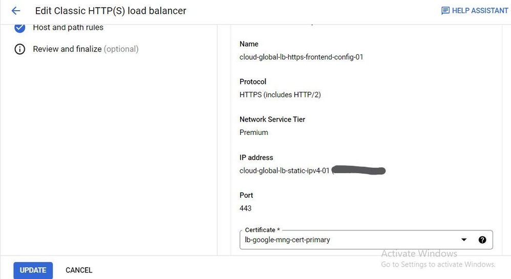

    7. Create your SSL Certificate. You can use Google Manager Certificate or your own Let's Encrypt certificate.
    9. Create your second HTTPS Load Balancer, buy 1 Global IP Address for your HTTPS Load Balancer and combine your SSL certificate with load balancer.

Hi, I still have the problem. The domain www.        shows FAILED_NOT_VISIBLE. Any idea please?
Finally and after trying a lot, the certificate became ACTIVE
But my site still appears as "Not Secure"

Despite all my long efforts, my site still appears as "Not secure", when trying to open it. Also the browser indicates that "Certificate is not valid".
I have a previously issued Active certificate and I tried to issue new one but it remains in Provisioning stage. I followed all directions and trying to solve the issue since long time.
