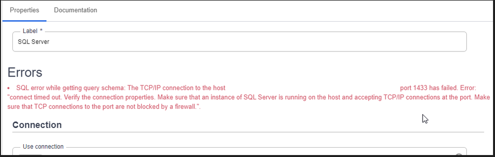

I am wanting to use Cloud Data Fusion to connect to some SQL databases in my organization. My organization needs to be able whitelist an IP address making the connection request.
I am unsure of the best route in order for my organization to whitelist the Cloud Data Fusion instance to connect to SQL database.
This is the error that I see within the CDF instance.
