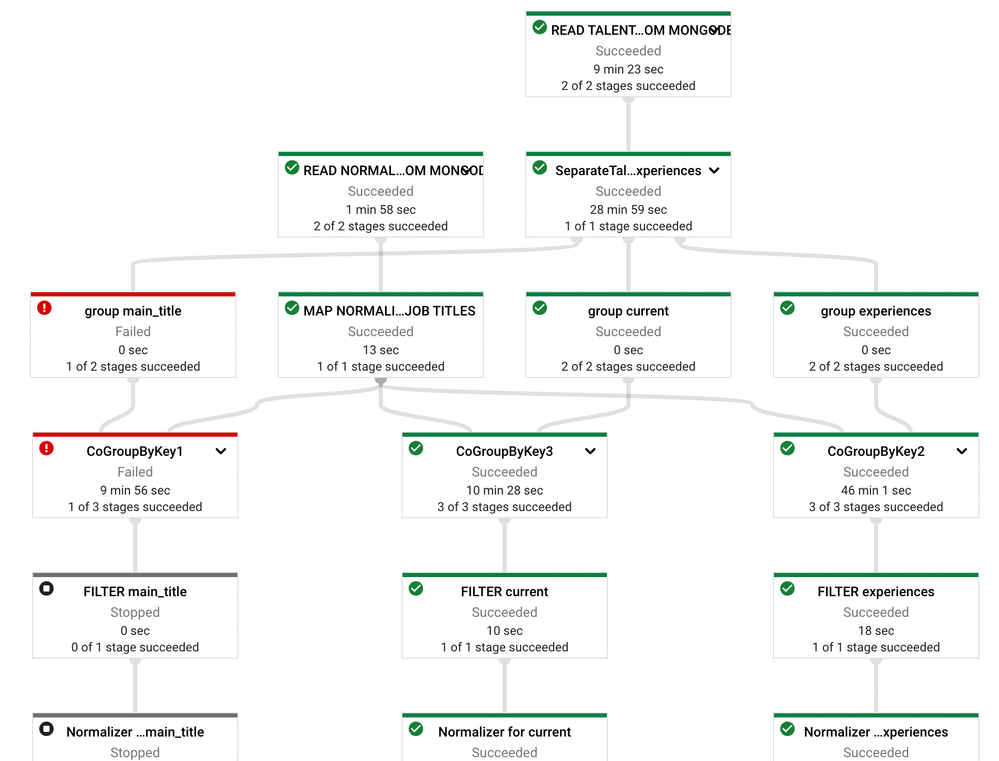

I have this DAG in dataflow. The part where it fails is in "group main_title" which is only a beam.GroupByKey()
As I understand, when doing GroupByKey operations, the runner will enable the shuffle service, which means it will take the data out of the VMs and send it to the Dataflow backend to apply the shuffle. Why is it failing?

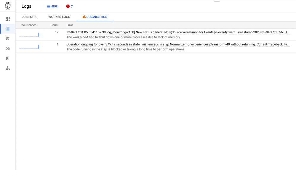

@ms4446 My bad. The worker VM had to shut down one or more processes due to lack of memory.
JOB LOGSJOB LOGSDIAGNOSTICSDIAGNOSTICS
Best regards
David Regalado
Web | Linkedin | Twitter
Thanks confirming the error messages. "Insufficient memory" error can happen if the code running in your Dataflow job is either blocked or taking a long time to perform operations, which can lead to memory pressure.
