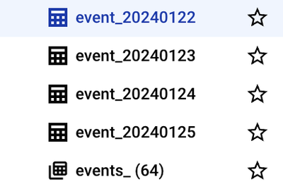

I completely understand! I just checked the latest table from today, and indeed it records from UTC 00:00 onwards. Thank you very much for your detailed response!
As I'm organizing the tables for the past data, I'm inserting data into each table based on UTC time. However, I've encountered an issue. The new tables I create take up a lot of space visually. Each time I create a new table, it adds another row to my dataset. I'm concerned that if this continues, it will become challenging to navigate the dataset once I have over fifty tables.
I noticed that the default 'events_' table, it collects all the table with prefix 'events_', so it simply increments a number when a new table is added, for example, from 'events_(54)' to 'events_(55)'.
However, the tables I create, such as 'event_20240122' and 'event_20240123', don't follow this pattern. Even though they share the same prefix 'event_', they don't automatically become 'event_(2)', 'event_(3)'. Is there a way to resolve this issue, or am I stuck with having to manually organize each table without the ability to group them together?
What I want is the first 4 tables can group together to be 'event_(4)', just like the 'events_(64)' down there.
Thank you so much!
There are a few ways to address this and keep your datasets organized efficiently:
1. Table Sharding or Partitioning (Recommended)
BigQuery's table sharding feature is the ideal solution for your scenario. Here's how it works:
  • Partitioned Table: Instead of creating separate tables like event_20240122, you create a single partitioned table named event_.
  • Date Sharding: You configure this table to be sharded by date. This means BigQuery automatically creates underlying partitions for each date, such as event_20240122, event_20240123, etc.
  • Querying: When you query event_, you can filter by date. BigQuery intelligently knows which partition to scan, making queries efficient.
Benefits:
  • Organization: Your dataset shows a single event_ entry. The individual date partitions are "hidden" but accessible by query.
  • Efficiency: Queries only retrieve data for the relevant dates, not the entire table.
  • Future-Proof: New days' data get added as partitions automatically.
How to Shard:
Check out the BigQuery documentation on date/time partitioned tables: https://cloud.google.com/bigquery/docs/partitioned-tables
2. Views (Less Ideal but Viable)
If sharding seems too complex, views can provide a workaround:
  • Base Tables: Keep your individual tables (event_20240122, etc.)
  • View: Create a view named event_ that uses a UNION ALL to combine data from these tables.
Downside: Each query against this view will scan all your underlying tables, potentially introducing performance issues if you have many tables or large amounts of data.
Thank you very much for your response! I've successfully grouped my table according to prefixes, and it looks very tidy now!
I have two additional questions to ask:
  1. Can I change the name of my table? Currently, my old tables use 'events_' as the prefix, so my newly created tables can only use 'event_' as the prefix. However, this splits my dataset into two parts: tables adjusted before March 13th are bundled with the prefix 'event_', while the newly generated ones still start with 'events_'. My idea now is to duplicate my old tables (those not following UTC time) and change the duplicated table names to use 'old_' as the prefix. This way, my newly created tables (following UTC time) can use 'events_' as the prefix, and they will be grouped together with automatically generated tables in the future. Is this feasible? Or are there any other methods to achieve the desired result?
  2. Strange things have happened since I changed the time zone of my Firebase Analytics to GMT+00:00. According to my research on BigQuery documentation, the 'events_intraday' table typically stores data for the current day and merges the data into 'events_' the next day. For example, the data from 'events_intraday_20240312' should have been fully transferred to 'events_' by 20240313, even considering any data transmission delays. However, I'm facing a peculiar situation where my 'events_intraday_' contains three tables: 20240312, 20240313, and 20240314.
    This seems very odd to me. Previously, I've only seen up to two tables in the intraday table (for the current day and the previous day), and usually, the previous day's table disappears around 10 o'clock on the current day. But now, there are still three tables present. Do you know why this might be happening? I've checked the connection between Firebase Analytics and BigQuery, and everything seems normal.

2. Understanding 'events_intraday_' Behavior
Insights into Anomalies: The presence of multiple events_intraday_ tables for different dates is unusual. It suggests a delay in the data processing or merging workflow. This could be due to a variety of factors, including system load or processing errors.
Steps to Investigate:
  • Review BigQuery and Firebase Documentation: Ensure your understanding of the events_intraday_ table's behavior aligns with the documented processes and expected behaviors.
  • Check for Delays or Errors: Investigate any potential delays in data processing or errors that might prevent data from being merged into the main events_ table as expected.
  • Contact Support if Necessary: If the issue persists, reaching out to Firebase or BigQuery support may provide additional insights.
  • Maintaining Data Access: Regardless of the anomaly, ensure your queries are designed to access both the events_ and events_intraday_ tables to maintain comprehensive data coverage.
Additional Considerations
Renaming vs. Re-exporting Data: While re-exporting data from Firebase Analytics with the correct timezone settings offers a clean, long-term solution, it's essential to weigh this against the potential impact on your data analysis processes. If historical comparisons are crucial, maintaining a consistent approach to naming and organizing your tables, even if it involves manual steps like renaming, may be advantageous for continuity and simplicity in your analyses.
The approach to renaming tables in BigQuery involves copying and optionally deleting the original. When facing unusual behavior with events_intraday_ tables, a systematic investigation can help identify and resolve the issue. Throughout, consider the broader impact on your data organization and analysis strategies to choose the most effective path forward.
OK! All my questions have been resolved! Thank you very much for your patient responses and incredibly helpful answers!
