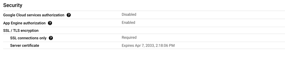

here is my cloud sql instance configuration
I'm using JDBC driver Version 12.2. Please help me to solve this issue.
