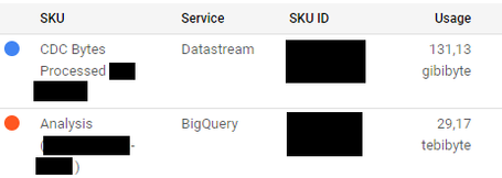

I was searching for some information about Datastream and BigQuery and did not find anything about my doubt.
My doubt is: I created a streaming Datastream -> BigQuery and my base was 130GB. But when I saw BQ Analysis it told me that 29TB was processed. Why did this happen? In this project I do not have anything work with BQ.

Good morning, my problem is in staleness configuration, because BQ always do a query before insert. Thanks,

Hi Aris, I don't understand how configuration changes on CloudRun relate to the question:
"Why does Datastream usage causes excessive BigQuery analysis charges?"
Hi @marcelocastro , thanks for the hint! I was having a similar issue and BigQuery analysis usage indeed went down as I increased the max_staleness settings.
