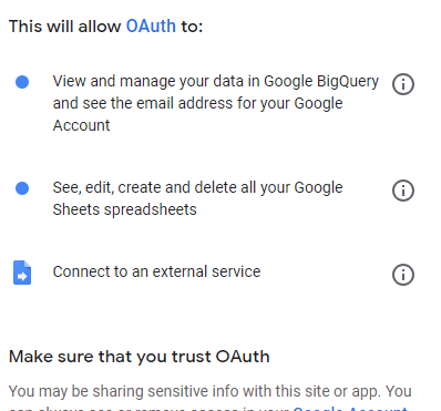

I wrote a function that removes authorization using
ScriptApp.invalidateAuth(); and wrote another one that calls for authorization using an UI-element. Using this technique I can now force authorization in Google Sheets directly and it does display the correct authorization scopes (see image)
EricPetermann_0-1702547459004.png.
Accepting still makes it so the script runs fine in the Apps Script Editor but gives the same authorization error when trying to run it in Sheets.
