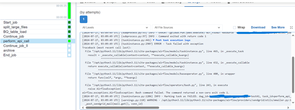

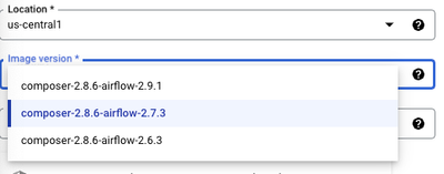

@DamianS  I'm using Composer-2.8.6-airflow-2.9.1 (latest version)
In the logs as well it is mentioned that the task ended with non zero exit code, but the task keep on running instead of failure.
PFB attached image of error.

@ms4446 , even I tried with above steps as well.
This time dag is getting failed as expected when I set only 'email_on_failure'= False in default arguments.
Otherwise the dag is keep on running as addressed previously.
When I set 'email_on_failure'= False, below is the log
And when I set  'email_on_failure'= True, below is the log
