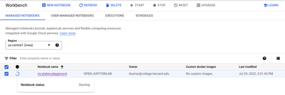

I've been waiting for this notebook to start for over 24 hours now. It contains over a thousand lines of valuable code and needs to be run for a time-sensitive project. It's been constantly stuck on "starting" without the options to stop or reset the instance for me to get access to it. Any ideas? Thanks!

Vertex AI cannot schedule your workload if Compute Engine is at capacity
for a certain CPU or GPU in a region.
What do you mean? I don't have any other Compute Engine workloads running, so how could I have used up my capacity? How do I get it back up and running?
This issue is also known as a stockout, and it is unrelated to your project
quota.
When reaching Compute Engine capacity, Vertex AI automatically retries your
Custom Job or Hyperparameter
Tuning Job up to three times.
I just need to access the code in the Jupyter notebook so I don't lose it. How do I get it to open to do that? I don't want to run any compute.
