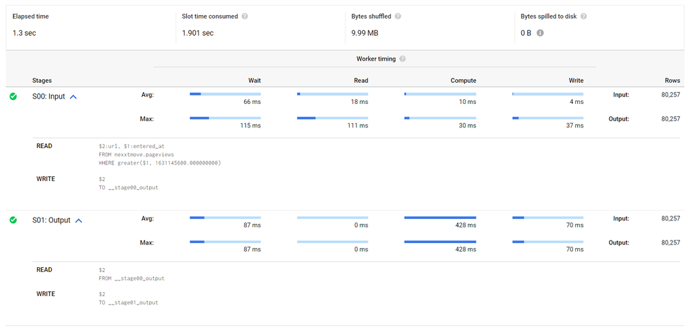

Does the Execution Details section have any clues? Look at the stage with the largest number of input rows and see what the READ section is doing (I suspect it's running a full table scan).
Also test with SELECT <columns> instead of SELECT * to see if that's causing it.
To keep costs down while troubleshooting you could create a temporary copy of the table with a limited set of rows and run your troubleshooting on that.

SELECT <columns> has no effect, still 300MB for every query regardless of the period.
This are the Execution Details (when using SELECT <columns>). I can't find any clues...
