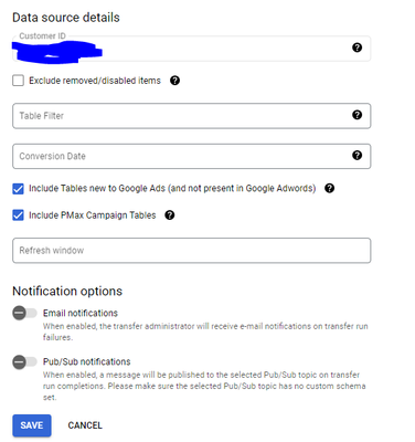

In the BigQuery data transfer settings "Edit Transfer" Page there is no option to update Transfer Owner
below is the screen shot of the "Edit Transfer" UI

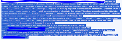

i jus tested my transfer it failing with below error

The error message "Request had invalid authentication credentials. Expected OAuth 2 access token, login cookie or other valid authentication credential." indicates an authentication issue. This could be due to a range of factors, including but not limited to:
  • The service account might not have the necessary permissions in Google Ads. Ensure that it has the "Read & analyze" permission level, and depending on the operations, other permissions might be required.
  • There could be issues with the service account keys or expired tokens.

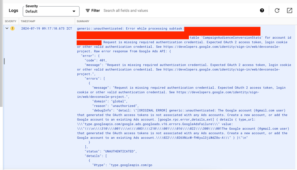

Here is the log says, we got 401.

I solved this by adding permission of the user setting up the job to have `roles/iam.serviceAccountUser` role on the Service account being assigned to run the job.
Ok I was premature on the above. This fixed some other errors but to get rid of the oAuth errors the only solution was to raise a support case with GCP, they then contacted google ads team who, and I quote
"Kindly note that the Google Ads Engineering Team granted the admin role to the service account mentioned."
It looks like they've manually accepted the invitation somehow in the backend, which we have no access to do as it's a SA, and the docs say an invitation never needs accepting.
