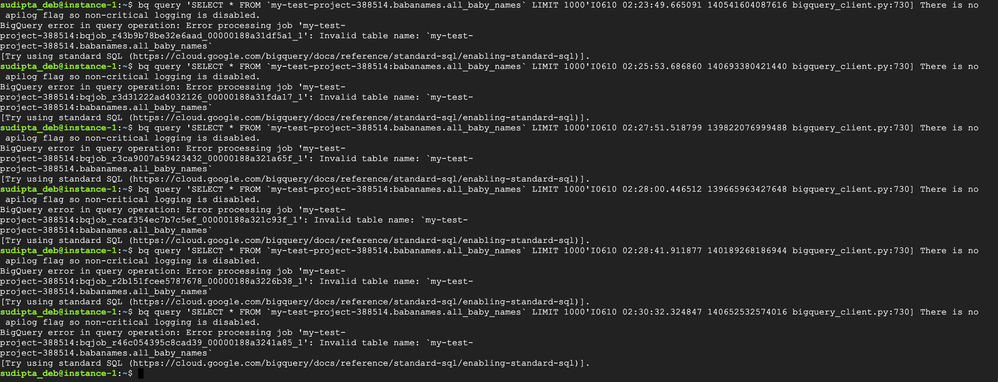

I made the changes as per your suggestion. The name of the table is:
all_baby_names. (See screenshot). But getting the same error (See screenshotError MessageError MessageTable NameTable Name
I was able to solve this by adding the parameter bq query --nouse_legacy_sql. Basically using standard SQL, the problem is solved. But not sure why I need to use the standard SQL? Any idea?
