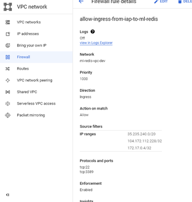

It looks like the firewall you created is only allow SSH traffic to devices on ml-redis-vpc-dev network. If you are looking to SSH from you computer over the internet you need to create a rule that allows you source IP address.
For example:
gcloud compute firewall-rules create allow-ssh-ingress-from-iap \
--direction=INGRESS \
--action=allow \
--rules=tcp:22 \
--source-ranges=35.235.240.0/20

Isn't that what the first entry in the screenshot above is?
Unobscuring the columns...
Is what I have here different from what you are describing?  The inability to connect as described above in the original post screenshots were taken with the ingress rule you suggest.
Sorry for the confusion. Replace 35.235.240.0/20 with your actual source IP.
(I was just using this IP address as an example)

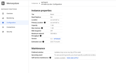

This is what my Memorystore for Redis console looks like.

But beyond that, as shown above, the only view I have onto the Redis instance is what is given by the Memorystore for Redis.    Is this what you are referring to?
This?
I guess I'm just not following how the text descriptions of things I need to look at map to the Cloud Console pages.

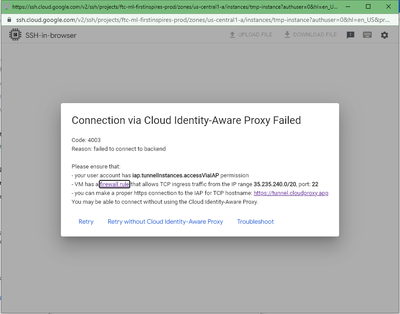

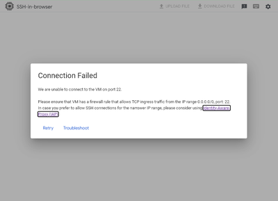

Thank you for being so patient, and I am sorry to be such trouble.  Let's take a step back and focus just just on connecting to the Compute Engine VM.
This is what happens when I click the SSH button on the VM instance page.
I am logged in as Owner of the project, and do believe that I have the required permission.
My VM is in this this network...
Which is the network that Memorystore instance is using.  And that's the subnet for the Memorystore instance also.  Although while I can see the network being used on the Memorystore page, I can't find where it will display the subnet, but when setting up the VM, when selecting the ml-redis-vpc-dev network, the only option for subnet is, as shown, serverless-subnet.
My firewall rules show "allow-ingress-from-iap-to-ml-redis" allowing the ip address specified in the error message above, along with the WAN ip address of my local laptop I'm sitting in front of, and a 172 address, which to be honest, at this point in time, I don't remember where that came from.
I also have a similar setup for the default network.  Taking shots in the dark...
I believe that I've satisfied all of the bullet points, and followed all of the steps you enumerated in your last message, and I think this screen shots show in detail what I've done.  And yet, still I can't SSH to the Compute Engine VM.

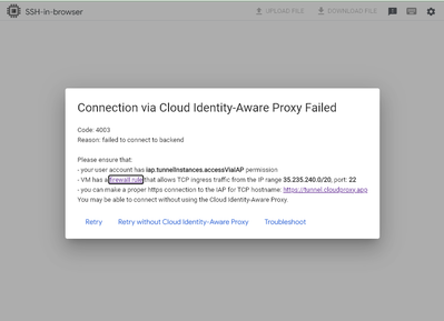

Additionally, trying with IAP as it suggests might work in the error message above results in...
And yet the firewall rule this message is suggesting I need, already exists...

You can check and update the firewall rules from the Google Cloud Console. Navigate to VPC Network -> Firewall and check if there's a rule allowing the necessary traffic. If not, you will need to create a new rule.
Also verified.  See screenshot in message posted here https://www.googlecloudcommunity.com/gc/Databases/How-to-connect-to-Memorystore-redis-CLI/m-p/553576...

Still can't ssh to the VM.
Ok, the curl command response (Error 400, bad path) suggests that the service is reachable (i.e., network connectivity is not an issue). So this is not the issue
Given that you've already confirmed the necessary User permissions and the firewall rule for Identity-Aware Proxy (IAP), the new error message suggests that there might be a broader issue with SSH access to the VM.

  2. Verify the VM's network settings: Make sure that the VM's network interface is correctly configured and that it has a valid IP address. In the Google Cloud Console, you can find this information in the VM instance's details page.
  3. Check the VM's status: In the Google Cloud Console, check that the VM instance is running and doesn't have any reported issues.
curl https://tunnel.cloudproxy.app/ returns 400 for an acquaintance of mine as well.  We are sitting about 300 miles apart on completely different networks.
Seems completely hosed.

And I can't login, presumably because it can't find the metadata, presumably because the network is unreachable.
How is it that the GCP web infrastructure can get a user tied into knots like this?
The error messages you provided are from the Google OSConfig Agent, which is a service that runs on VM instances and provides features like operating system patch management, package installation, and configuration management. This error suggests that the instance doesn't have network connectivity, as it's unable to reach Google's metadata server. Most likely the same reason why you are unable to SSH into the VM. Here are a few things you can check:
  1. Instance network interface: In the Google Cloud Console, go to the VM instance's details page and check the network interface settings. Make sure that the network, subnet, and external IP settings are correct.
  2. Instance startup script or system logs: Check the instance's startup script (if there is one) and system logs for any errors related to network configuration. You can access the system logs from the serial console, and the startup script from the instance's details page in the Google Cloud Console.
If these steps don't help, you might want to consider stopping the instance, taking a snapshot of its disk for troubleshooting purposes, and then creating a new instance with the same configuration to see if the issue persists. If the new instance works correctly, there might be a problem with the system state of the original instance.
