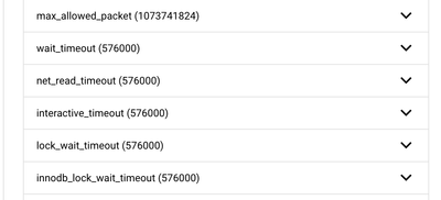

I am connecting to CloudSQL (MySQL 5.7.39) using MySQLWorkbench (Ver 8.0.1.3) for Mac.
I have followed the usual solution and set some of the global variables for timeouts in MySQL
After 300 seconds I can see that the query is still running on the server but the error has appeared in the client.

The client timeout settings are also set to above 300 seconds
