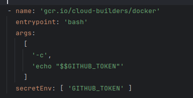

I got the same issue but I still got no luck with this here:
The GITHUB_TOKEN is set in my secret manager (no doubt about that). Yet I still get a 401 error when `npm i` gets called from within the Dockerfile.
I did even what I was not supposed to do in order to verify that the token is actually set - and it is:
Something is fishy here 🤔
Oooff.. it was me. I dynamically update the GITHUB_TOKEN in my CI/CD and made the mistake of echo-ing the secret. The problem: without -n there will be a \n added to the token which is invalid.
The error presented to me was not helpful though.

What did you do differently? I'm noticing the double quotations. Facing the same issue - thanks
