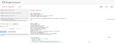

I have generated a OAuth 2.0-Client-ID for my cloud project. Using the https://developers.google.com/oauthplayground/, I executed all the steps which are needed for my opinion to get a working refresh token to use with, for example, curl:
If I use the refresh token mentioned, the curl answer is unauthorized_client.
