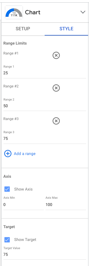

In Looker Studio, gauge charts only display one metric.
So, we need to create a metric that calculates the percentage you're looking for. We can get this by turning the YES/NO value into a 1/0 value, then summing that and dividing by the total count.
SUM(IF(<used template>, 1, 0)) / COUNT(<used template>) * 100
Once you've created that, there's just a little fiddling to do with the ranges and targets. In my example, I made ranges for every 25%, set the target to 75%, and set the max axis to 100%. Images to follow:

This did seem to work but just a quick question - the aggregation is currently set to SUM - does htis have any impact on the output?
Yeah, SUM should be fine! It would basically be summing our calculation over all the rows. But since the gauge chart only returns one row, it'll return the sum over just one row, which is the value itself.
Interestingly, my calculation is set to AUTO and I can't change it. But if I could, SUM is what I'd choose 😁
