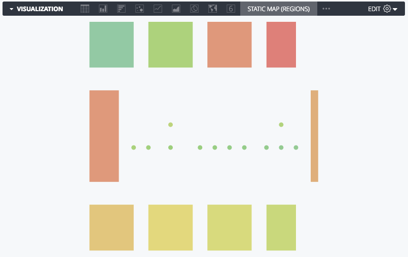

Today someone asked me if they could use an event floor plan as a map in Looker.
Since it took me a little bit of work to figure out the easiest way to do this, I thought I would spare you the effort by posting my method out here.
From a power point:
To this map in Looker

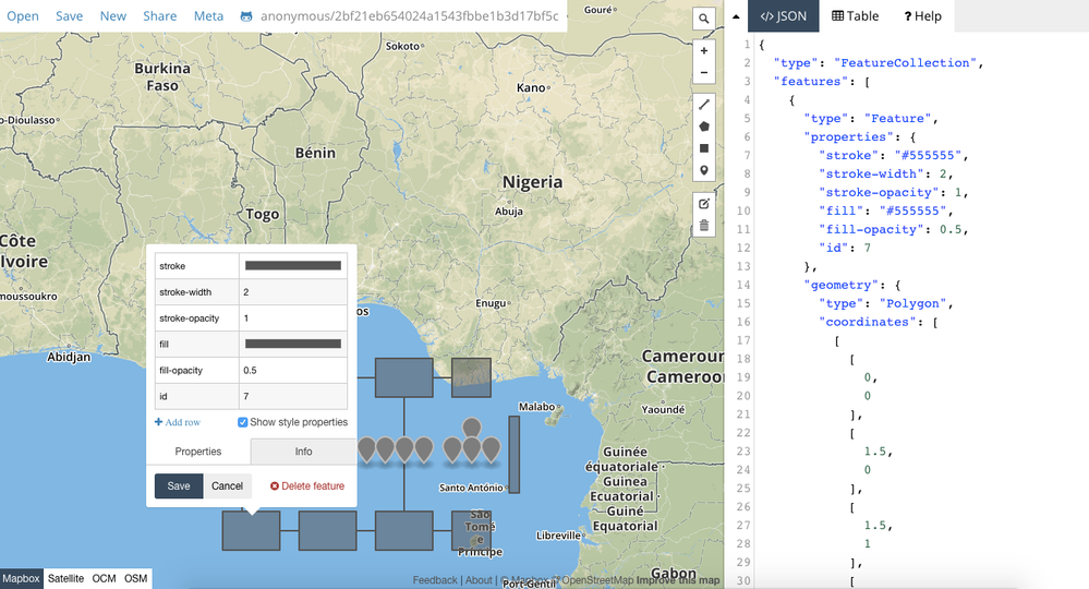

  • Go to geojson.io
  • Use the drawing tools to get an example of the geojson text structure on the right and then write by hand the shapes and sizes you need.
  • For example a rectangle looks like this:
Which allowed me to eventually build this:
  • For each of the shapes created, selecting them on the map allows you to add attributes.
  • These attributes are the values Looker will be trying to link the dimensions to.
  • They are crucial to be able to map the table results to the map in Looker. (Notice the id field in the example)
  • Save your newly built map as a TopoJSON. (There is a button for that)
