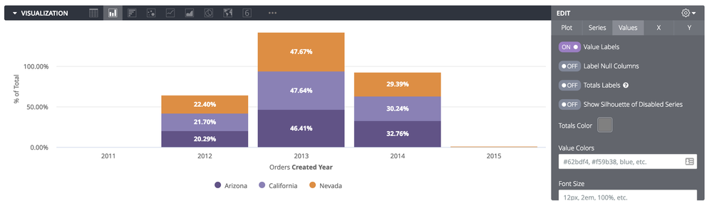

We could however, visualize just the percent of total over time as shown below. Note that the y-axis shows the percentage and not the total, as in your example.

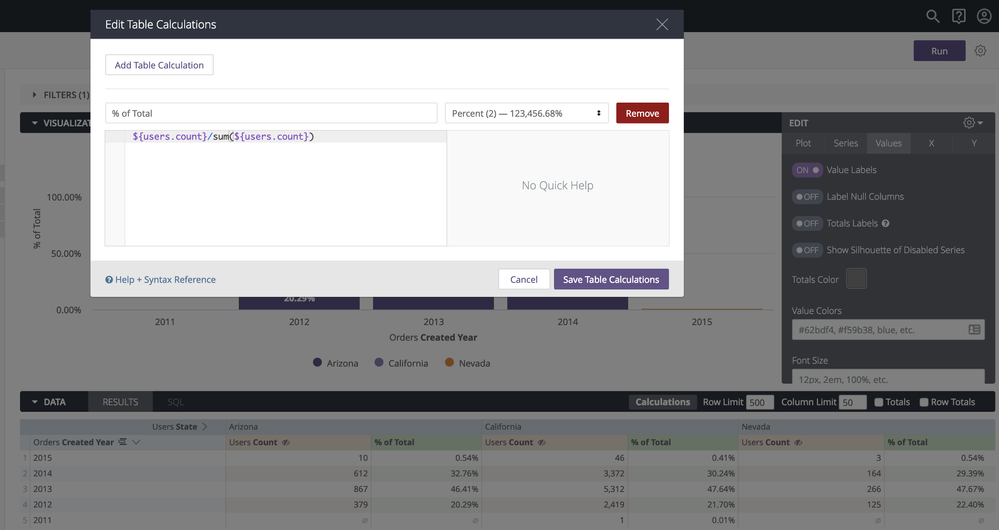

Hi Paola, would you be able to share how you were able to create this? i’ve been working on something exactly like what you made but couldn’t figure it out.
Hey @Catherine_Huang, sure thing!
We can create the percent of total field using Table Calculations. In my example above, I used the function ${users.count}/sum(${users.count})
Once you have that, you can hide the the Users Count column from the visualization. Change the visualization plot settings to “Stacked” and toggle on “Value Labels”.
