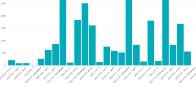

Hi, I am trying to create a graph with dimensions: date & name in the X axis, with some measures that are stacked.
I’d expect the visualisation to group multiple names that belong to the same date & display the date only once. But that doesn’t happen & as a result part of my x labels is trimmed if the label is too long.
what I get:

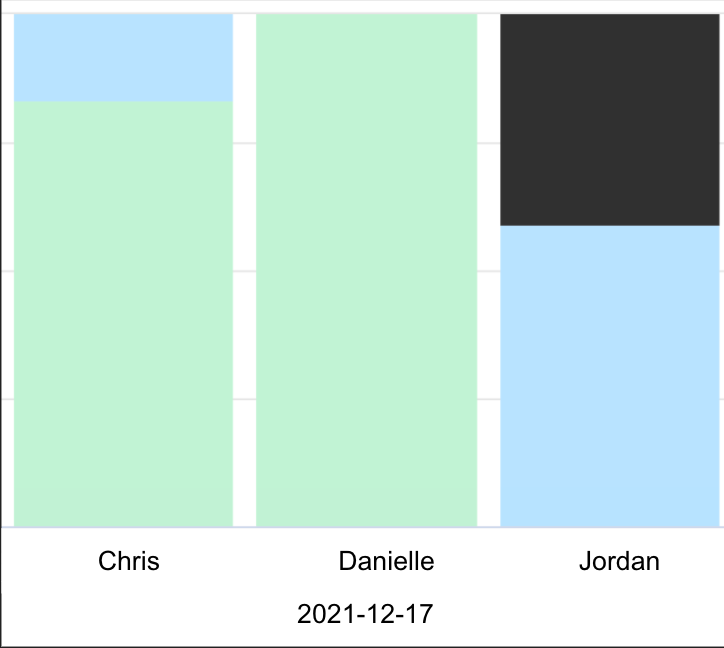

what I’d like to have:

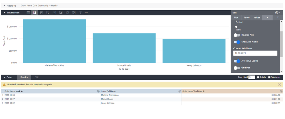

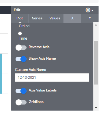

This is possible with changing some custom settings in the visualization. go to visualization settings and give a custom X axis name.
under X axis tab, enter the custom axis name, in your case “ the date”
then you have to hide the date from the visualization.
Then you’ll get you expected result. I hope this helps.
once you click hide from visualization, the date doesn’t show up in our bar chart
@Vimal1 thanks for the detailed answer.
Unfortunately, this is not what I was looking for.
I am looking for a solution that would work programatically on multiple dates, and with changing data, so I can’t name the entire x axis with one specific date.
Thanks.
