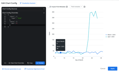

Hi @DataAnalytics, a couple of suggestions - one option would be filtering the Days Before Estimated Arrival column to be >= 0 which would cause the x-axis to update its minimum value. However, if that gets rid of rows that you'd like to visualise, another option is using the Advanced Chart Config Editor to set a minimum x-axis value, which should work for Cartesian charts - example given below.
