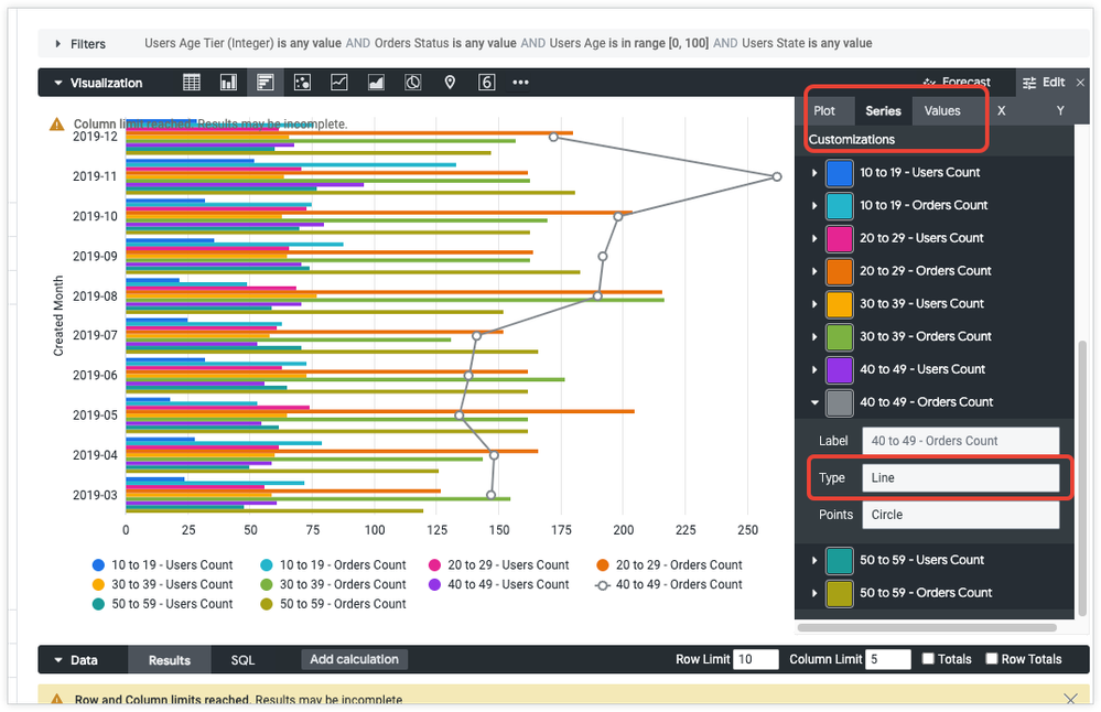

Good morning everyone. Do you think there is a way to create a barchart with Looker that has a Country dimension on the y axis, a Revenue dimension on the x axis and at the end of each bar a numerical value (% delta between current year's Revenue and past year's Revenue)? So in this case the percentage delta would be like a label.
I tried entering the delta as a measurement and displaying it as a point in the graph. The problem with this solution is that for many bars the value overlaps and is therefore not clearly visible (especially since it is not possible to label only the delta percentage value).

Hello There,
To keep the bar style graph and label the delta without overlapping, I think the best option would be to use mix graphical component like this example.
Considering an alternative visualization option might be worth it as well if you are looking visualize a large volume of data!

Yes, in the end I also opted for this solution, hiding the line! Thank you so much for your help
