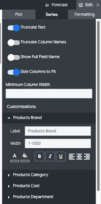

My only workaround when I want several table reports to align in a dashboard (and so manual resize it to make it equal size columns for all table reports), it's setting an equal number for the width of the column in each table report.
When you go to the settings of the visualization there is a section where for each column(field) you can specify a width size:
It's not a perfect workaround but still it's a way to make all of the tables to have the same size for each column.

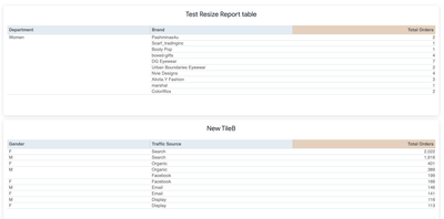

Using the Report Table, i've tried this:
Selecting Even in Layout and de-selecting the Auto scale:
The result makes the tables look like this in a dashboard:
Is that what you are looking for?
but when I have more than 3 cols the option even was not scaled to full size, Do we have another way to resize manually or the same size for all cols
Yeah, there are some limitations after certain amount of columns/fields selected...
