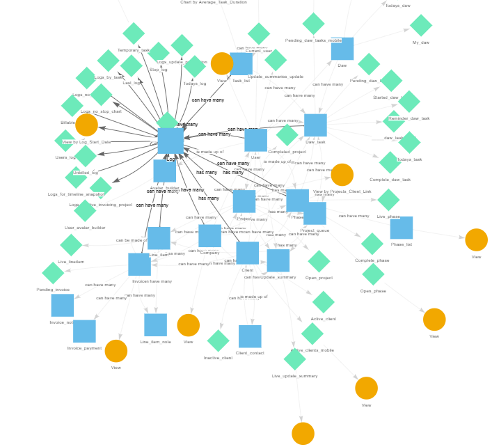

New Chart Type Suggestion: Hierarchy
Sometimes it can be very helpful to see connections between things in a literal sense. Prime example: Spec graph view.
This can be very helpful to illuminate the connections to things, and having a similar representation inside an AppSheet app as a chart could be useful in some instances.
I could see something where you add tables to a list (like selecting the columns that should be included in a chart), and we would see some sort of hierarchy chart showing how things are structured.

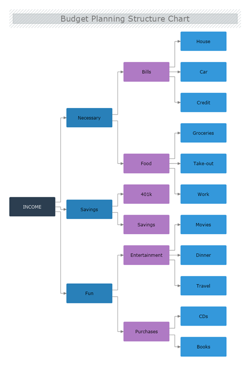

I agree with you @TDhers. To put it in more generic terms the data model would be something like:
ID ParentID <Detail Columns for ID>
Where Parent ID always refers to an ID in the current table. This approach is the proven industry standard to keep a clean data model using the requirement that a child can have one and only one parent.
If you flip it where the parent tries to list all its children then you are forced to maintain lists of unknown length. a bit messy.
To use @MultiTech_Visions graph above, The first two levels of nodes (yes that is a technical term ) would be represented by the data table below. This model allows for any depth down the tree and for any number of children for a parent - limited only by the resources.
ID  Parent ID   Category
A    <null>      Income
B       A        Fun
C       A        Savings
D       A        Necessary
E       B        Purchases
F       B        Entertainment
G       C        Savings
H       C        401K
I       D        Food
J       D        Bills
<level 3 nodes>
