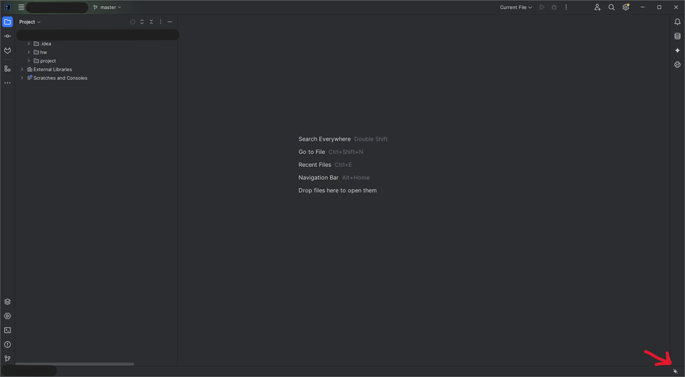

I had the same issue and spent so much time on it, its ridiculous. But the solution is actually very simple. There is a teeny tiny icon of the plugin in the right bottom corner of the IDE. Just click on it and you'll find the Log out option at the bottom of the appeared drop-down menu.

@aihgii  I am facing the same issue, but couldn't find the icon. Could you please help with the IntelliJ version that you are using and share the screenshot to refer?
Sure. The screenshot attached is from IntelliJ IDEA 2024.3.1 (Ultimate Edition).Screenshot 2025-02-06 104212.png
