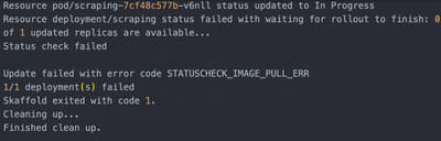

Thanks a lot! I'm still familiarizing with it so that seemed to be the error. I managed to deploy the function and make it run properly. However, I tried to deploy a new one and when I run it on the vscode extension I get this error:

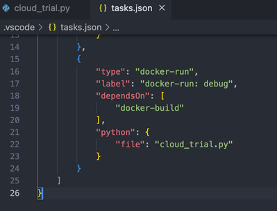

The launch.json folder looks like this:
  "configurations": [
      "name": "Deploy Cloud Function",
      "type": "cloudcode.cloudfunctions",
      "request": "launch",
      "functionName": "scraping",
      "gen": "GEN_2",
      "revision": "scraping-00001-biy",
      "entryPoint": "hello_get",
      "testInput": "",
      "region": "europe-west1",
      "runtime": "python310"
      "name": "Cloud Run: Run/Debug Locally",
      "type": "cloudcode.cloudrun",
      "build": {
        "docker": {
          "path": "Dockerfile"
      "image": "scraping",
      "service": {
        "name": "scraping",
        "containerPort": 8080,
        "resources": {
          "limits": {
            "memory": "256Mi"
      "target": {
        "minikube": {}
      "watch": true,
      "internalConsoleOptions": "neverOpen"
      "name": "Python: Current File",
      "type": "python",
      "program": "${file}",
      "console": "integratedTerminal",
      "justMyCode": true
      "functionName": "function-scrape",
      "gen": "GEN_2",
      "revision": "function-scrape-00003-vuh",
      "testInput": "",
      "name": "Docker: Python - General",
      "type": "docker",
      "preLaunchTask": "docker-run: debug",
      "python": {
        "pathMappings": [
            "localRoot": "${workspaceFolder}",
            "remoteRoot": "/app"
        "projectType": "general"
Any ideas on why this might be happening?
