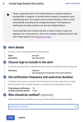

When I try to follow this description, it works for me. Here what I do in the Cloud Console window:
  1. Select the current project to be the one that own the logging bucket to which logs get redirected.
  2. Open Log Explorer for the selected project.
  3. Press "Refine scope" option.
  4. In the opened window select "Scope by Storage" option and the logging bucket under this option. Note, if you do not see the bucket there it means you don't have access to that bucket. Review the documentation to understand what IAM roles you need to have the access.
  5. After refining the scope, press "Create an alert" option (above Query results to the right) and follow the steps.
The alert will be created for the refined scope. I provide these steps in details to show exactly what I did to get the desired result. If these steps do not work for you please, point at which step you stop.

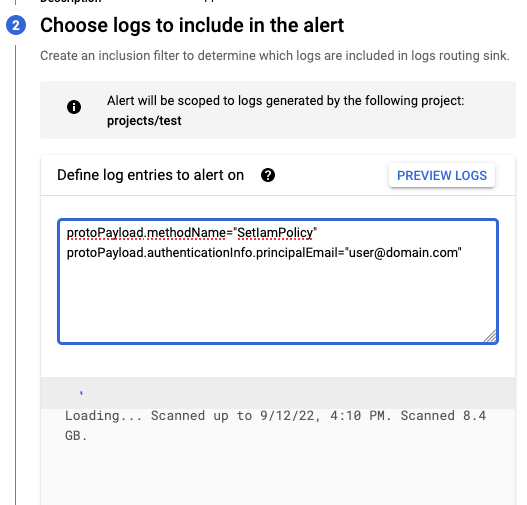

When I select "Refine scope", when viewing in Logs Explorer I see the logs I need, but when I create an alert, it does not work with the same filter, because the "Refine scope" parameter is not inherited.
Therefore, when you say that you get the desired result, it can mean 2 reasons:
1) you are using the default logging storage in the project, not using custom storage (which I have is an organization-wide aggregator)
2) standard logs from your project match from logs from user storage
Below I show screenshots:
- in Logs Explorer I see the logs I need
- when creating an alert, they are no longer found

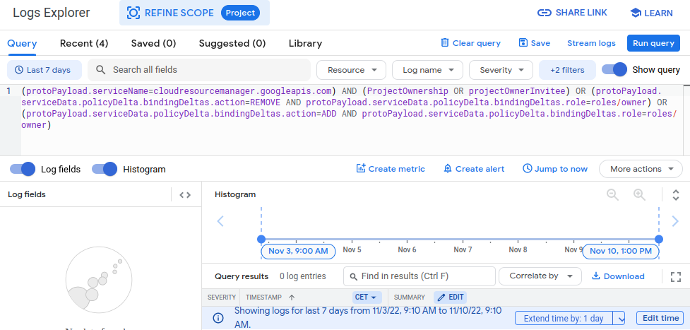

But I still have to click "REFINE SCOPE" and select the bucket when selecting "View logs for metric" in the "Log-based Metrics" screen (Screenshot 1 and Screenshot 2)
This means I can't create alerts on this logging metric, right? Because even if I select the audit bucket as the refined scope, creating an alert won't take that into consideration.
Also, selecting "Create alert from metric" from the "Log-based metrics" view also doesn't seem to work (Screenshot 3).
And FYI, there are logs in said bucket (Screenshot 4):

Thank you for the detailed description. I will try to address your questions.
I tried to create the logging metrics as in the alpha docs, declaring a bucket. But I still have to click "REFINE SCOPE" and select the bucket when selecting "View logs for metric" in the "Log-based Metrics". Might I have done something wrong?
The syntax looks valid to me. The UI might be confusing but it makes sense that when you select "View logs..." you see the results of the filtered query. So, you still have too define the explicit scope to provide the info that you passed for the log-based metrics using --bucket-name.
The reason why you see nothing in the alert's preview chart is because log-based metrics are not calculated back in time. They start to measure only after the moment you create it.
Try to generate events that create new logs and check that you can see these metrics. You do not need to go to the alert UI for this. You can check them in Metric Explorer.
You're right! I generated a few new logs by adding owner role on a few accounts in different projects, and they show up in the alert policy based on the logging metric I created 🙂 Thanks a lot for taking the time to assist me on this random thread... I hope this helps others aswell.
