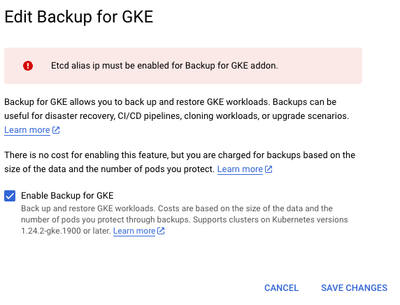

When I try enable the GKE backup on the cluster's settings in GKE I get this error:
"Etcd alias ip must be enabled for Backup for GKE addon"
See screenshot aswell:
I know this error seems pretty self explanatory. Implying I would have to recreate the cluster with etcd-alias IP enabled.

Well suddenly it worked. After waiting the weekend.
So for anyone else reading this.
Just wait a few more days and try again 🙂
