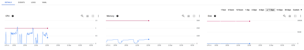

An example of the CronJob deployment details screen for one job shows an abrupt end to the metrics and nothing in the four days since despite the job continuing to run on the same schedule:

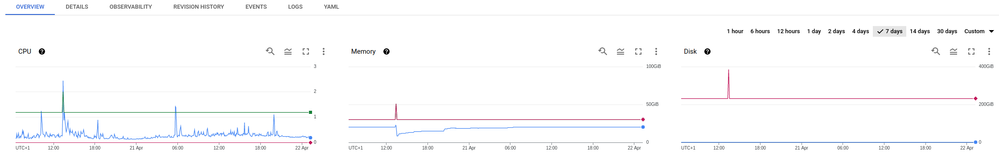

Metrics for non Cronjob deployments on the same cluster still work as expected:

As I mentioned the issue is affecting all CronJobs across multiple clusters with the only commonality being:
  • they are in the same project
  • the Kubernetes versions are the same (control plane: 1.24.10-gke.2300, node pools: 1.23.11-gke.300)
It's possible that the issue is being caused by the difference in version between the control plane and nodes, however I can't see anything in the logs that suggests the control plane was updated at that time. Any other suggestions welcome.
