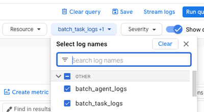

Hi, @wenyhu
I found the cause of the problem because my instance is of SPOT type and was preempted, but I did not find the relevant log in the GCP logger, but found it through the instance log. Can this be optimized?
Hi JonYu,
I would expect you find some preemption related logs when on your pantheon UI, you click on Logs -> LOGGING -> batch_agent_logs, if spot instance preemption is the cause of your job failure.
Would you mind sharing the logs you get for your job so that it also helps Batch to check whether the logs meet our expectation?
Thanks!
Hi, @wenyhu
I filtered some business logs, through the gp logs, I did not find the reason why my JOB exited.
Reason: Instance eligible for autohealing: instance should be RUNNING, but is STOPPING."
