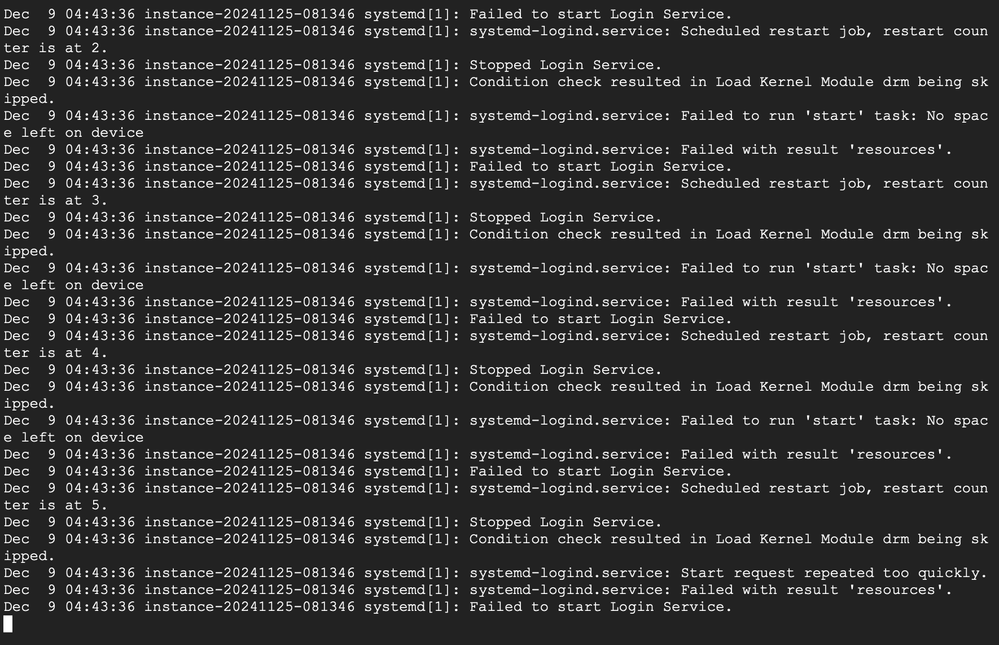

Because of this weird error, I couldn't connect to SSH after fixing my firewall connections, serial console  would not start login service because of a full boot disk.

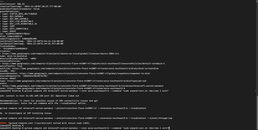

So i downloaded google cloud CLI and tried connecting from my terminal, didn't work. Then it mentioned I had a full disk and it needed resizing. Which i have done multiple times while troubleshooting.

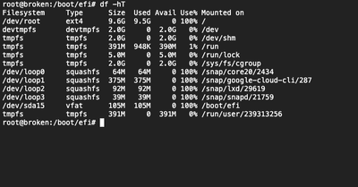

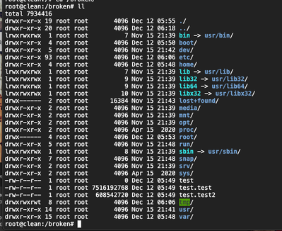

I’ve intentionally filled out disk space.
That caused following error:
So I’ve stopped VM. Expanded BOOT disk from 10 GB to 50GB And started VM again. Still the same
In theory I should be able to resize it from terminal in my case. But I want to simulate your case, so imagine that I’m not able to use terminal at broken VM.
1. I’ve stopped broken one.
  1. Once done, I’ve detach boot disk.

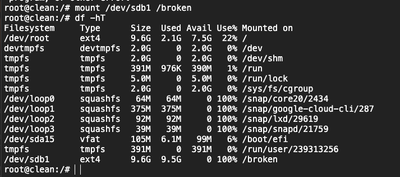

  1. then I’ve picked clean VM and attached EXISTING DISK ( boot disk from broken one)
  2. Next, I’ve logged to clean VM.
  3. fdisk -l presented that broken disk is being visible from OS perspective
  4. As root, I’ve created mountpoint named “broken” and mounted device with type Linux filesystem
  5. As you can see, we have all files from broken VM ( now you can clean FS or do anything).

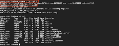

  6. Lets’ resize disk.
We will going to use two commands
growparth DEVICE PARTITION_NUMBER
resize2fs /FS

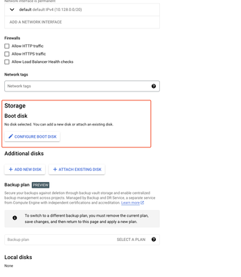

  1. Umount /broken mountpoint. Shutdown VM
  1. Detach disk
  2. Configure new disk on broken VM
  1. save config and start VM.
Boot disk has been fixed

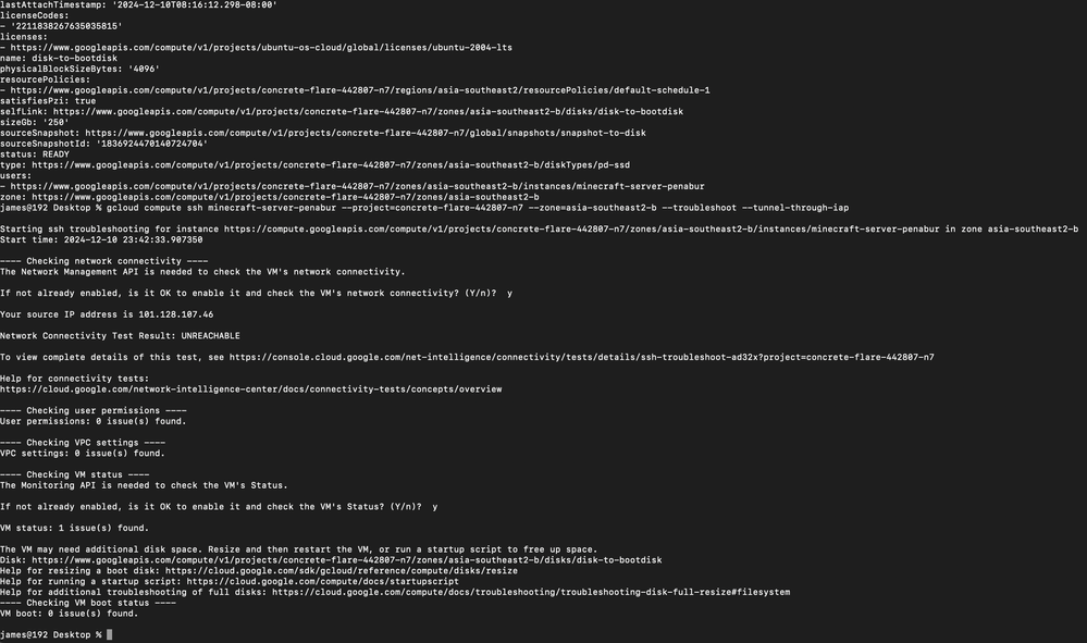

So I only resized it from the GC UI, I am unable to access the VM terminal since I can't access SSH and serial console. This is because the bootdisk hasn't been resized in both GC UI and the terminal. But I need the terminal to resize it. So it's like a loop I can't break.
The only solution I've thought of is to resize it through the startup script, but I don't know how to do that.
And accessing or resizing with ssh through GC CLI is also not possible.
GC CLI errorGC CLI error
I've tried using --troubleshoot --tunnel-through-iap. It gave the same error, saying that the VM needed more disk space.
It gave 2 links to resizing and trouble shooting with serial console. Both required ssh and serial console which I can't access.

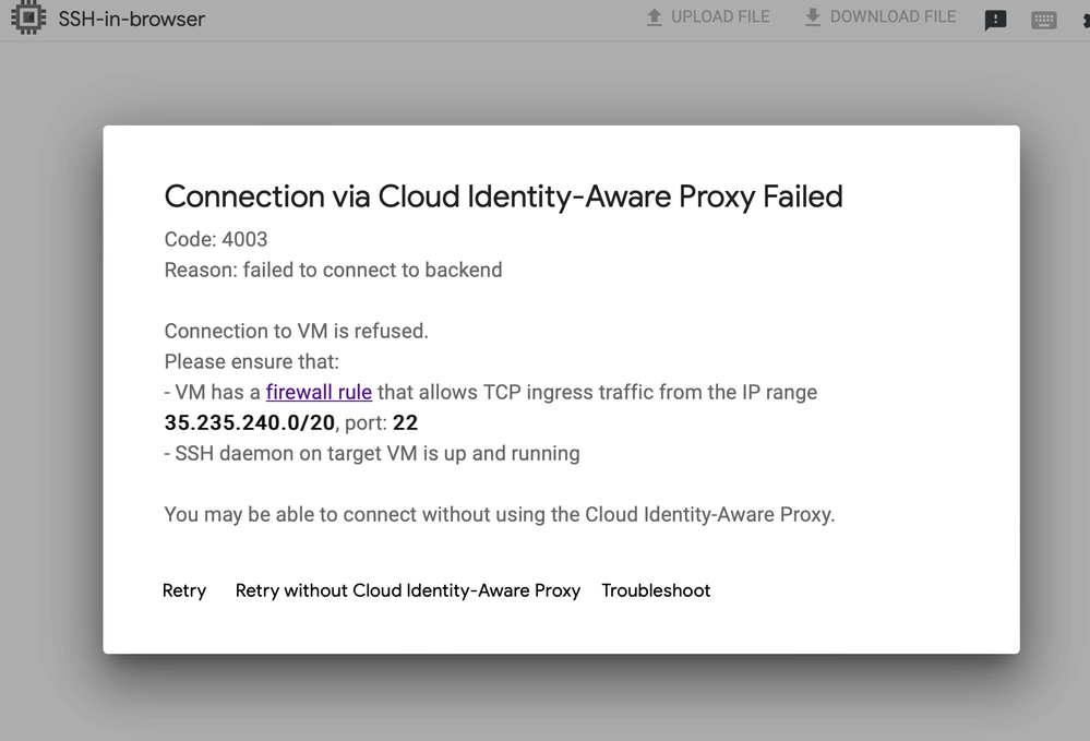

I have also made sure my firewalls worked with checking the firewall and the SSH and TCP configurations in IAP (I don't remember the name but I think that was it)
But my ssh still gave the same error:

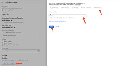

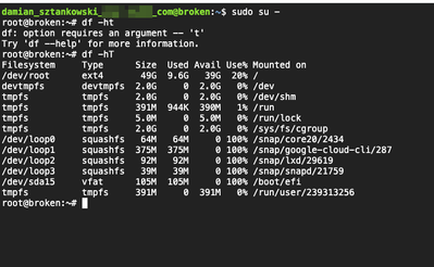

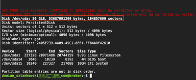

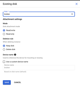

Please see this tutorial:
resize2fs /FS
  1. Detach disk
