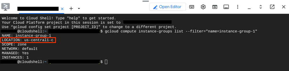

1. Identify the Exact Zone
  • Using gcloud CLI:
    gcloud compute instance-groups list --filter="name=instance-group-1"
    5MddxHUh2BGLYnn.pngThis command will list all instance groups, look for the LOCATION column in the output to find the specific zone where instance-group-1 is located. Let's say it's in us-central1-c for this example.

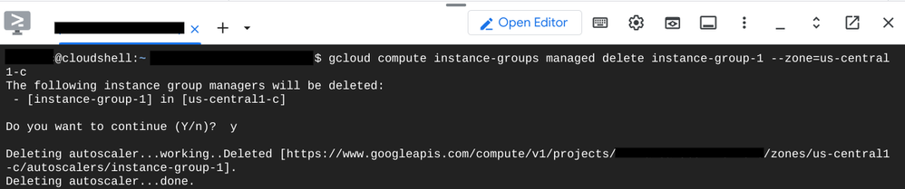

2. Use the Correct Zone Scope When Deleting:
  • Using gcloud CLI
    Now that you know the zone (e.g., us-central1-c), use the --zone flag:
    gcloud compute instance-groups managed delete instance-group-1 --zone=us-central1-c
  • Using gcloud CLI:
  • Using gcloud CLI
