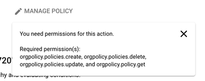

I am the sole owner of the organization, yet when i wanted to modify a policy, it says that i don't have the permission:

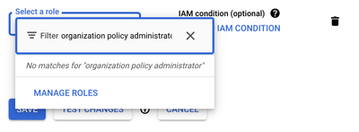

I researched and noted that the Organization Policy Administrator role has those permissions, yet, when i want to assign that role to myself, it doesn't appear on the list:

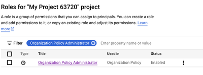

Even though i see it in the roles list:

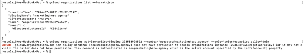

@oteiza-a I am facing same problem can anyone help @DamianS i run you code at google cloud shell but it throwing error
Screenshot 2024-04-28 091939.png Pls check what wrong i am doing here
Hello @riyoutku  ,Welcome on Google Cloud Community.
This doesn't looks like orgID. You've provided "DIRECTORY_CUSTOMER_ID" instead of organization ID.
Use this command to list all organizations and find your and provide ONLY number after organizations/
gcloud organizations list --format=json
cheers,
DamianS

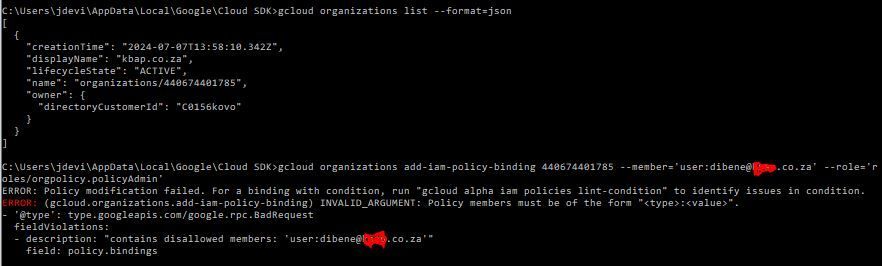

C:\Users\ProoBook\AppData\Local\Google\Cloud SDK>gcloud organizations add-iam-policy-binding ****--member='user
:developer@neonrain.studio' --role='roles/orgpolicy.policyAdmin'
ERROR: (gcloud.organizations.add-iam-policy-binding) User [developer@neonrain.studio] does not have permission to access organizations instance [***:getIamPolicy] (or it may not exist): The caller does not have permission
even tho i using my owner account and i am the sole owner of this organization

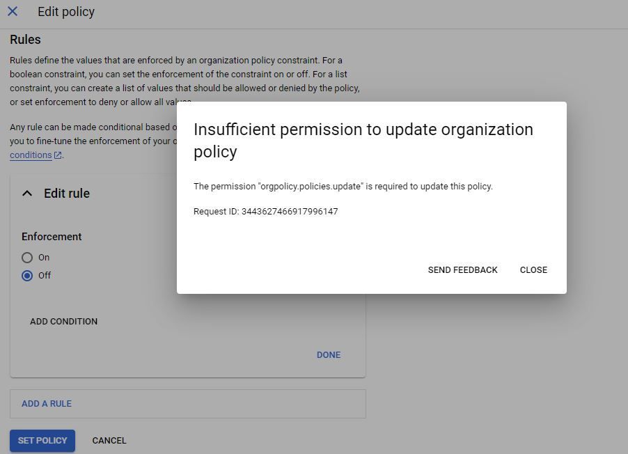

Good day all, I am having the exact same issue. Can anyone help me? I need to create an JSON account key to Migrate to Microsoft 365.
When I try to disable the Disable Service Account Key Creation policy, I get the below errors
