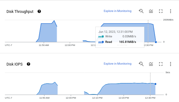

Enabling oslogin causes system to have high Disk IO
We are getting rid of project-wide SSH keys and enabling OS Login.
For some reason, doing so causes the instance to have high disk IO - to the point where the system is inoperable.   Has happened on 2 out of 14 systems converted.  One is on Ubuntu 20.04 the other Debian 11.  The systems where it was fine, Debian 11 and Ubuntu 22.04.
Even after shutting the instance down and restarting it, within a few seconds, the system is again inoperable and in Observability - high disk IO.
Any way to fix this or why it's happening???

Update - issue solved.
We had another outage today on our VPN server - which was a blessing in disguise.
My colleague had noticed that Promtail wasn't running on it, so he started it up.
Withing 2 minutes, the server was hosed, issue is, OSLogin makes use of /var/log/lastlog and we had Promtail configured to scrape all logs in the /var/log directory.
We changed Promtail's config to only look at:
/var/log/*.log and /var/log/syslog
As you know, lastlog is a "sparse" file but it was causing Promtail to lose it's mind as it can grow (but not really taking up disk space).
Rgds...Geoff
More information:
Even after backing out the "change to OS Login", the system is still inoperable.
Had to shutdown, remove boot disk, create new boot disk from a recent snapshot.

Thanks for that detailed reply, I appreciate it.
As far as "OS Login daemon configuration", there isn't any?
I followed this guide:  https://cloud.google.com/compute/docs/oslogin/set-up-oslogin
Installing on a per instance level, so the only configuration is setting metadata:
enable-oslogin     TRUE
I have enabled this on 28 out of 39 instance we have.  The issue I posted has happened on only 4.   During that time, the system is inoperable, so I can not run any commands at all - I can only watch the load via GCP console.
Editing the instance and removing that configuration doesn't fix it.
1 instance, which is very critical, we used a snapshot and restored the system just prior to the change.  The other 3, we waited, one took 4 hours and the other 2 took 5 hours and suddenly, the systems were fine.
It's almost as if some one hot swapped a mirror disk and mirroring put a strain on the primary disk.
We are a small organization with only 4 of us that actually login with shell.
Systems are mostly Debian 11 and a few Ubuntu 22.04.
Hate to use the cliche, but I have been a SysAdmin for over 30 years and I have never seen something like this before.  🙂
But I do want to understand it, that is, when you enable oslogin, what happens to an instance?
Does it read all the inodes for some reason?
Why did only 4 systems (so far) get hit with this?
Sigh, signed into a system today with OS-Login enabled - and the CPU spiked and the disk is thrashed with IO....
Rgds...Geoff
