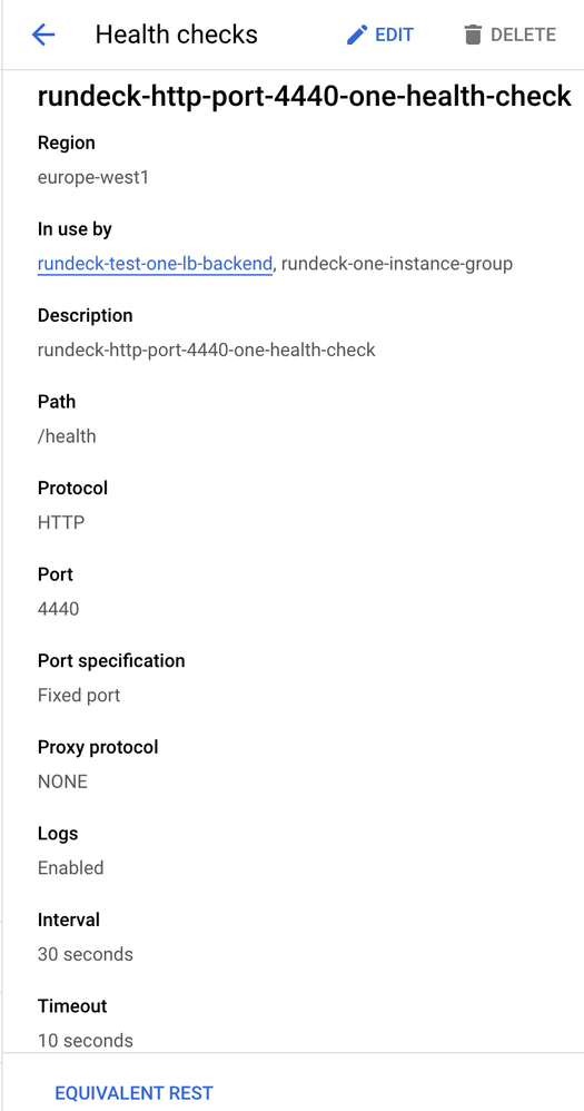

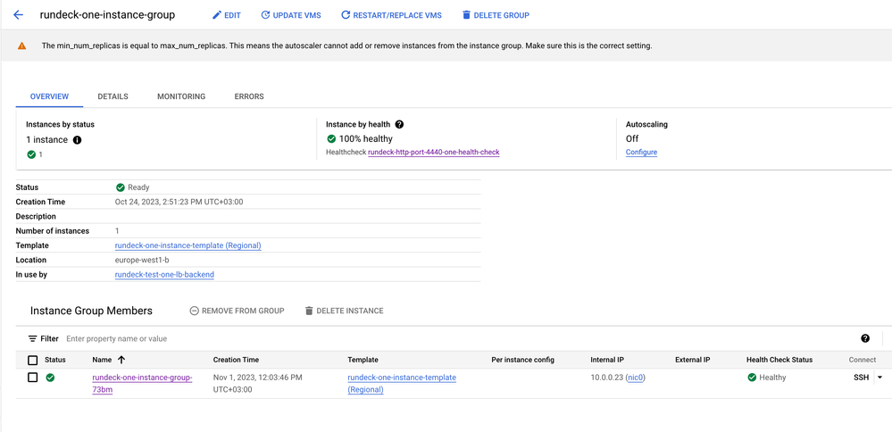

I'm trying to point my external load balancer to backend runs on port 4440, but I don't know what's missing tho the health check works fine.
And accessing the service from inside the managed instance(using wget) is working.
when I try to access the page using the load-balancer IP I'm getting a text says "stream timeout" and I'm allowing all traffic from LB IP.
So, what is that I'm missing here? I added a health check for the port that service running at and it's working.
firewall.pnghealth_check.pnginstance_group.pngloadbalancer.pngresponse.pnglb-allow-fw.png

Hi @her_I_am ,
Upon checking the details that you've provided, it seems to me that your backends were healthy.
The VPC firewall rules will have no effect on the Load Balancer IP as these  rules are associated with the instances within your VPC, and they control the traffic to and from those instances.
