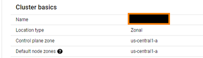

This shows that the cluster is in zonal and in us-central1-a zone so, I should be able to find it in us-central1 region.
Hmmm ... I think you are saying that your Google Cloud console shows the existence of a cluster but when you run gcloud to list the clusters from the command line, you don't see any clusters.  Is that the core?  Let's check a couple of things.  First, in the console, make a note of which exact Google Cloud project you are looking at.  Next, in the command line for gcloud, add "--project <ProjectID>".  If you don't specify an explicit project then the default will be used (see gcloud config list) and it may be that you are looking at the Dataproc configuration in a different Google Cloud project than you expect.   Let's also check that you are using the same identity for your queries in both the console and the command line.
Yes your understanding is correct.
  1. project is correct on shell
  2. response for stop shows the correct project
  3. adding --project resulted in same error (projects/my-project/regions/us-central1/clusters/my-cluster --> both my-project and my-cluster is correct
  4. correct account and project shown for gcloud config list
Gosh ... I'm getting stumped on this one.  I hear you say that the console says you have a Dataproc cluster but the command line says you don't.  We have tried applying the explicit project name that hosts the cluster to the command line and still it comes back and says "no clusters".  You have looped through the list of all regions using "fancy" shell scripting and still don't see it.
The next thing I'd suggest we do is look for something subtle ... let's posit that the console is lieing to us (I hope not).  I'd do a hard browser refresh and see if the cluster listing goes away or somehow changes.   What I'm fishing for is some possible caching of data in the browser that is listing something which isn't there.
