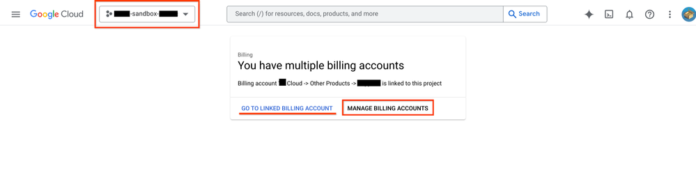

1. Confirm Project and Billing Setup

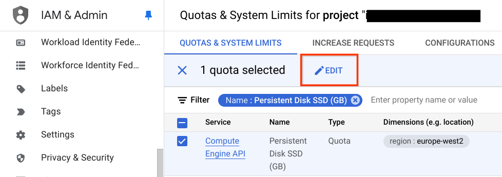

2. Check Quota Details
3. Request Quota Increases
  • Select the quotas you need to increase and click EDIT
  • Fill out the form and provide justification for the increase.
