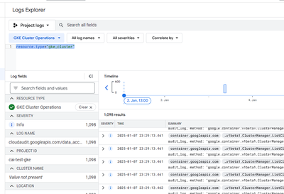

To know what parameter to insert (include/exclude part), try explore it in the Logs Explorer. For example if I only want my Sink to ingest GKE logs only.

For the monitoring, is something like this sufficient for you?
