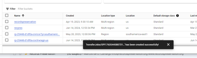

I got the transferred created, how do I start it?
Thanks!
You go to create transfer and set your source to a file system, then select the agent pool you've created.
