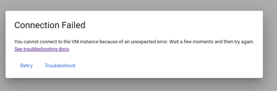

I have GPU compute instance it worked, I had changed some of the settings inside the container - via chown and chmod, so I wanted to reset the container using reset option - I thought it would get to the begining settings but it did not worked
Administrator created second image I did the same experiments and now I can not connect to VM so I am sure that that resetting did not got the image to the starting point.
When I run the instance from cloud shell I get
jakub_mitura@ ...... .: Permission denied (publickey).
jakub_mitura@ .....  : Permission denied (publickey).
after doing
--troubleshoot --tunnel-through-iap
I get at the end
You need permission to SSH to a private IP address: iap.tunnelInstances.accessViaIAP.
Help for IAP permissions: https://cloud.google.com/iap/docs/managing-access
- Your organization hasn't blocked access to external IP addresses. IAP changes the source traffic to 35.235.240.0/20 and the tunnel to https://tunnel.cloudproxy.app.
---- Checking VM boot status ----
VM boot: 0 issue(s) found.
But I had permissions because I was able to open instance at the beginning
Without creating new instance which is complicated in my case what can I do?
